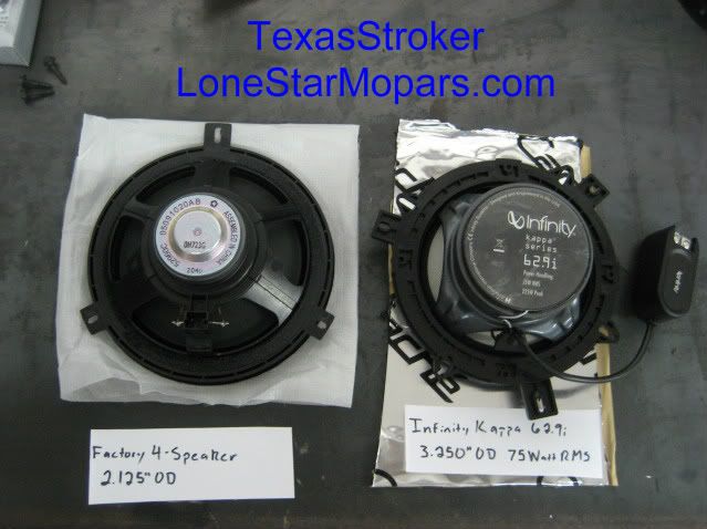

We will be upgrading from the factory, paper-cone disgrace to an Infinity Kappa 62.9i:

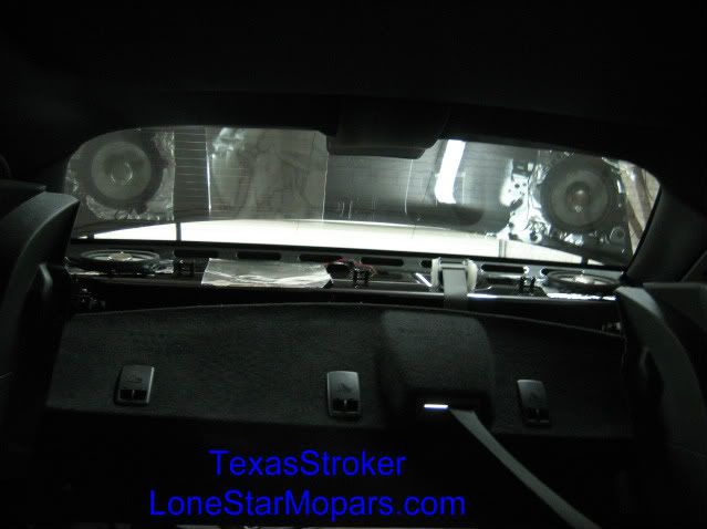

The end product will look like this:

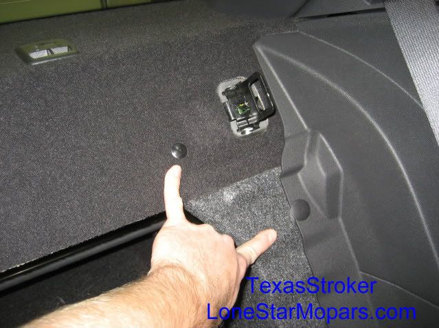

When you see the seat latches just to their inside will be a pretty large retaining clip.  This essentially holds the rear deck panel upholstery in place.  Slide your trim tool under, pry up, and store it aside.
Now come in and find the retaining clip that holds the rear door panel to the that same piece.  Slide the trim tool in, pry up, and set it aside.  If I remember right the heads are two different sizes, so keep that in mind for reinstallation.
Now, repeat the retaining clip removal on the other side.  You are now ready to wrestle with the rear deck panel.

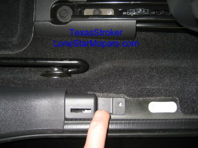

This one is a pain.  Not tough, but a pain.  You might have to pull on the rear door panel to release a few clips for more clearance as well.  Don't pull it hard near the rocker because it is anchored with a #2 Phillips Screw:

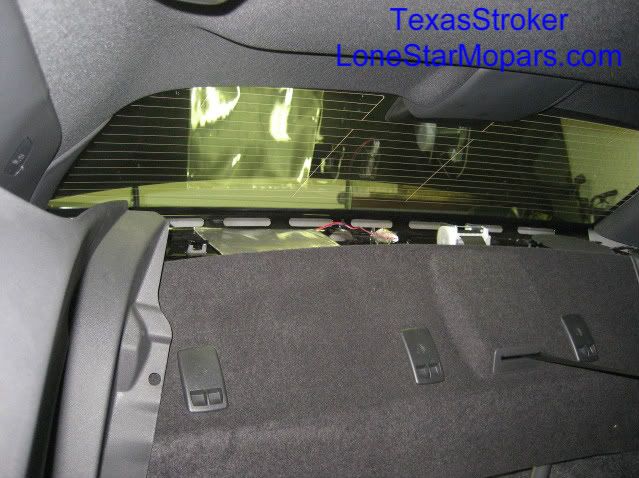

Before you just grab it and pull it out and down, note that the edges are stiff enough to scuff up your C-Pillar material.  The C-Pillar is that trimmed piece that runs from the headliner to the package tray along the rear glass, just like your A-Pillar does up front with the dash and windshield.
What I found was best is to start on one side, pull forward gently, and as soon as an opening appears towards the C-Pillar get your hand/fingers in and bend the rear portion down.  This will let you flex the deck plate just enough to clear the C-Pillar without scratching it up.
Do the same for the other side and then slowly weasel the entire rear deck panel down the frame, along the seatbelt, and to a point where you can access the rear speakers:

Step 6: Removing the Rear Speaker
Finally, an easy and gratifying step.  All you do here is lift the speaker up, disconnect the factory wiring, and toss it out for woodland critters to laugh at.

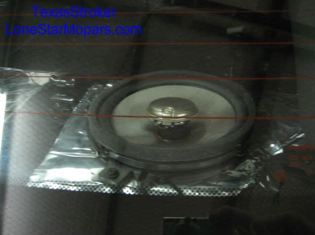

Step 7: Dynamat
Since you are upgrading the speaker, why not go the extra step while it is easy to do and put down some sound deadener.  This will help reduce rattles and vibrations to further enhance your new speakers.
This is straight forward, cut a piece to fit, pull the back, smooth it out, and then cut around the hole.  It is hard to lay down a perfect fit thanks to the wiring and C-pillar proximity, but anything is better than nothing in this case.

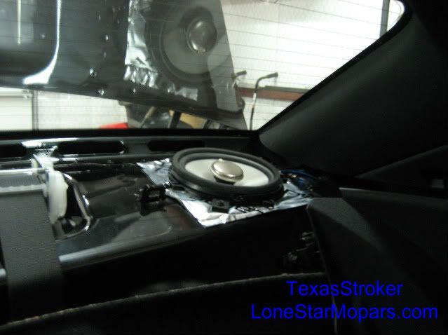

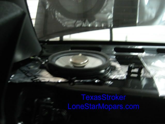

Step 9: Install the Speaker
Once you have the wires in place, go ahead and set the speaker down in place.  Note that many will require an adapter to fit in the factory opening.
Use the same (3) #2 Phillips Screws and tighten it down:

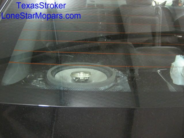

Passenger Side:
Driver Side:

Again, make sure you have sound, like the sound, and go ahead and dial-in any aftermarket settings like swiveling tweeters etc.
