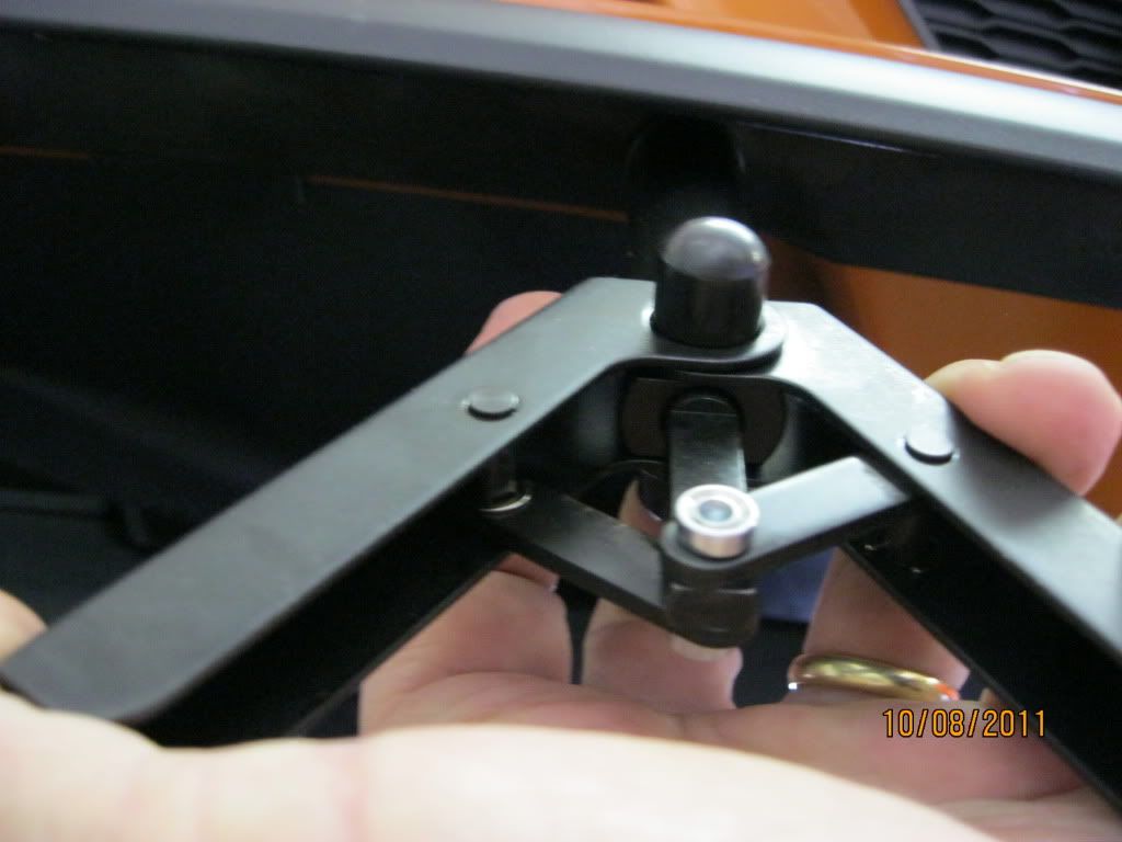

Tools: Tape, Sharipie, Tape Measure/Ruler, Drill, 1/4" Spur Drill Bit, Hand Rivet Gun (due to low clearance)

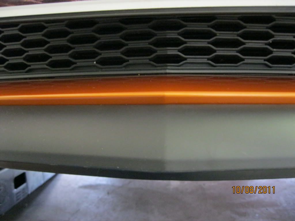

Here's the front of the car stock.

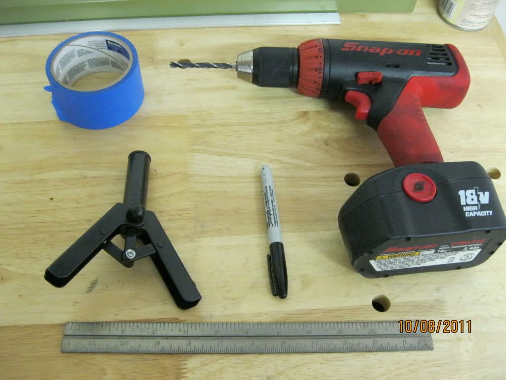

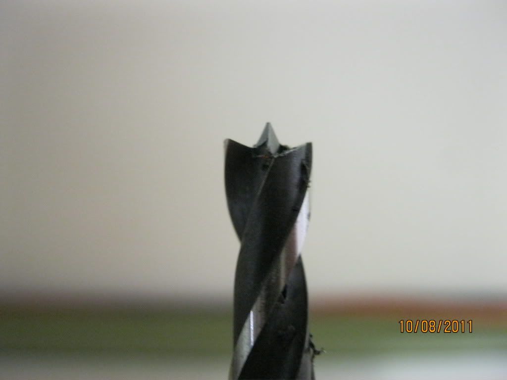

Tools needed; Drill, 1/4" drill bit,masking tape, Sharpie pen, ruler, Pop rivet gun
The drill bit I used was a spur bit used for wood work to prevent splintering and it work great for drilling plastic panels.

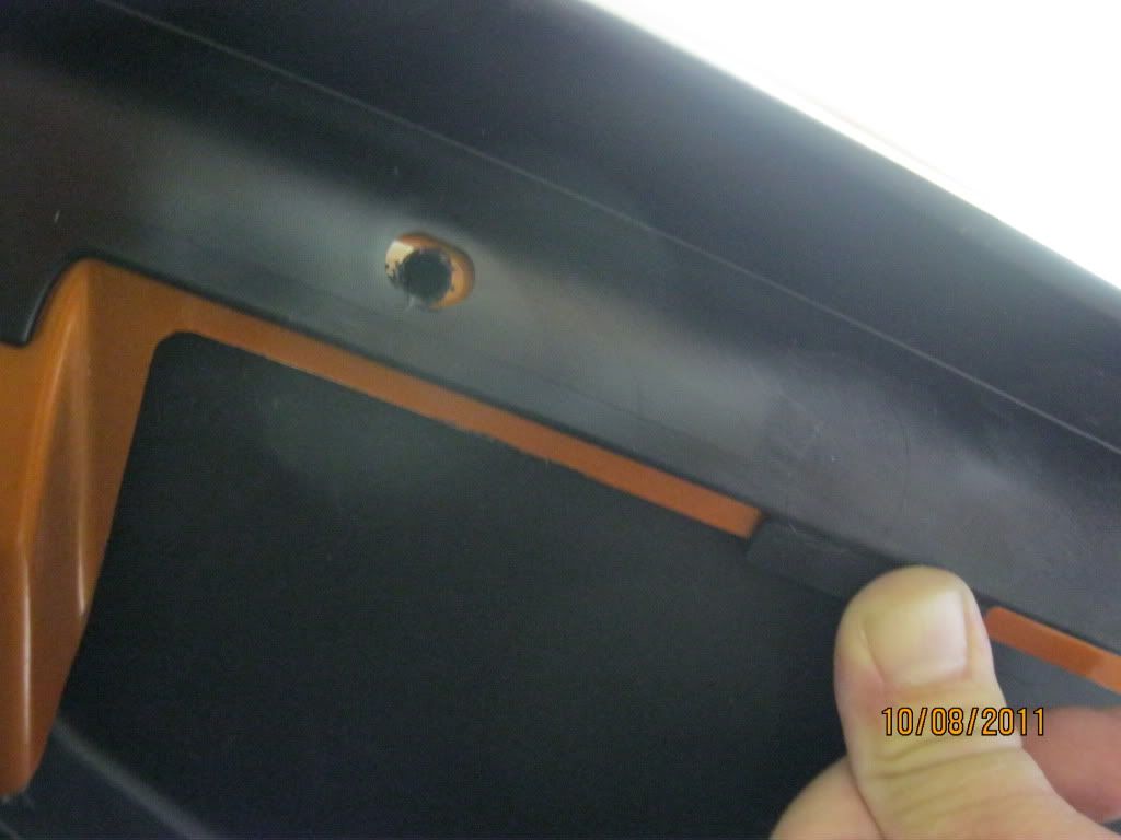

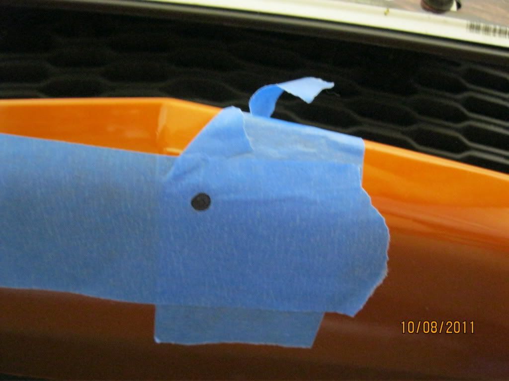

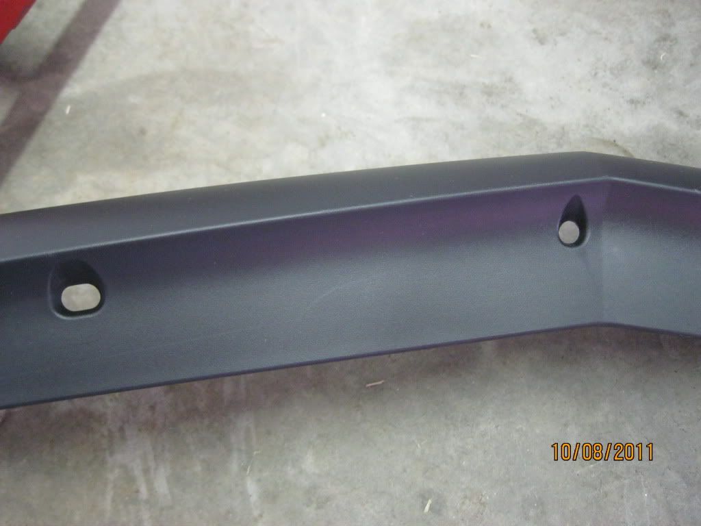

The center hole in the spolier is not slotted like the other 10 so I marked it first. There are clips on the spoiler that you use as a gauge to set the placement of the edge since it does not fit flush with the front cowl.
Once you have your first mark after you have measured twice, it's time to drill a hole in your car...

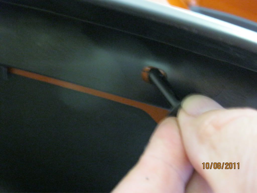

Then it's just a matter of installing a rivet and moving on to the next hole, each time before you drill make sure the spoiler is at the proper height.

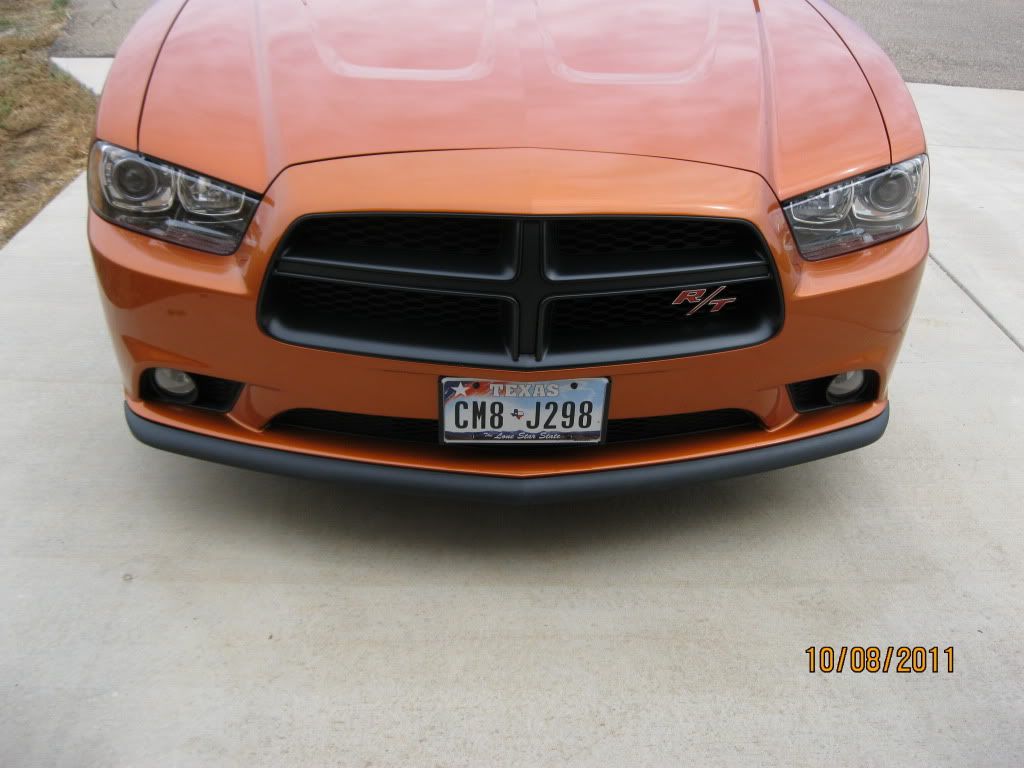

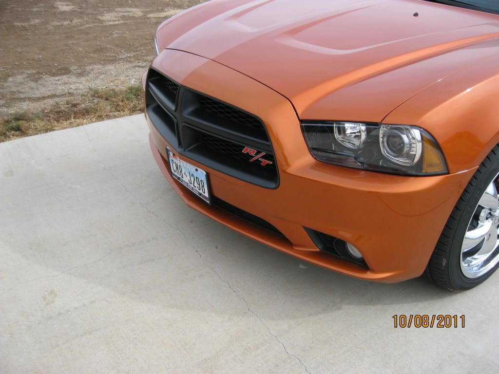

Here's the finished project;
